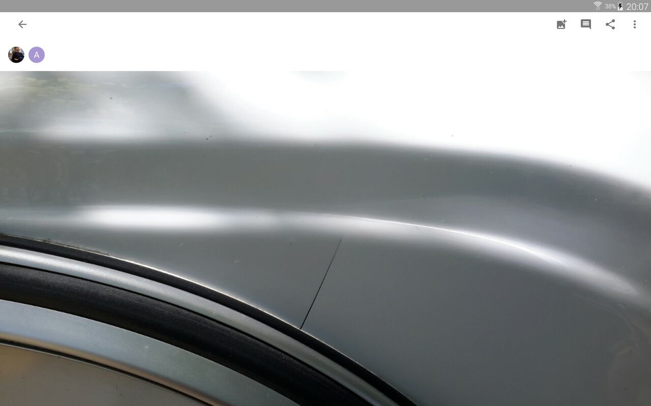

When I was cleaning it I noticed some mastic just where the crack is on your picture.Probably got a crack as well. Had a look at the roof first thing this morning when it was cool. It was not as bad but could still see ripples in the roof but not as bad. Had a look when I got home and it was bad again.We had some bad look with our swift caravan. We got a coachman thinking they where better made. Not the best start with it.

I did notice this crack when we were in the south of France two years ago at 38c. . At that time the van had covered about 15,000 miles of touring. Coachman had it back and replaced the rear panel under warranty. No arguments. We love this model, Had a 2010 545 VIP. Didn't get on with it , but the payload was fantastic. I think 195 kg.

Hi all. Had a look tonight and roof is still rippled but not quite as bad as it has been. I all so had a look at the back panel and we defiantly have a crack under the mastic.
