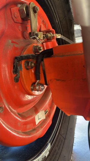

"Don’t know if anyone else has done this but I put temperature sensors on the hubs on my caravan to monitor the temperatures via the cerbo."

So it's a good idea in theory, however there is a large mass of steel to act as a heat sink which will skew the value. Next time you pull up, check the outer hub with an ir temp gun and then the stub axle and see the difference.
Josh Hutton
Author
Christopher Inch doesn’t have to read the exact temperature of the stub axle. You just get to know what “normal” operating temperature is and if it goes much higher than this baseline you know you have a problem.
