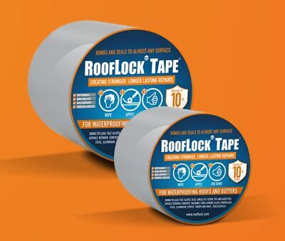

I would think about using a tape, such as Rooflock.
Now my van is out of warranty, I keep thinking about covering all roof joints with this tape.
I would not drill any holes in the roof. If the water is puddeling then it is not going into the caravan, I don't care about the roof of the van, It is covered in Fenwicks Winter stuff, don't wash it off, just give another coating every year.

If the roof joint tape is in good condition there’s no need for Rooflock or Eternabond tape. It could even devalue the van if put up for sale by making a buyer wary.
