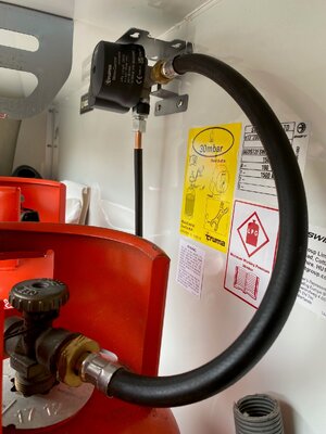

No, buy the correct pigtail from an accessory shop, they aren't expensive, as others have said, one end will screw onto your bulkhead regulator and the other onto your gas bottle. All straightforward but remember that the fitting that screws onto the gas bottle is a LEFT handed thread. This is mine, the black item is a newer version of the bulkhead regulator that you have, the other screws directly onto the cylinder.

For Richtee's information:-
GaryB's picture shows a bulkhead regulator with a flexible pigtail for connecting a PROPANE bottle, which has a different connection to the BUTANE cylinder on his own fittings.
Richtee you need to ensure you have the correct pigtail for the type of LPG cylinder you have. Propane cylinders have a male "POL" connector
Butane cylinders come in two types Dumpy bottles and older larger Butane cylinders use a female (the larger end)
More recent larger Butane use a clip on device
Which is the device you already have, combined with the correct pigtail.(Above)

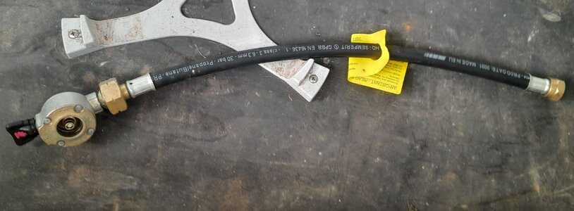

Does post #21 show a butane connector in the photo?
