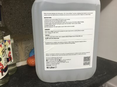

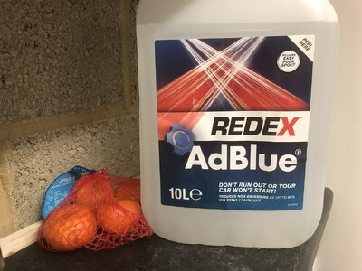

Which means the Adblue in your tank will be one year at least out of date. The Adblue I bought last week looks like this. Note the loose label on the cap dated April 2023. But says nothing when it must be used by. Confused ?

Some sites advise 12 months from DOM if still sealed and 6 months if container is opened. But there must be lots of diesel owners that do low mileage per annum and the adblue is in the cars tank far longer than 6 months. Just another thing to fret about…… DPF, SCR, DMF etc. 😂
The AA advice seems pragmatic.
