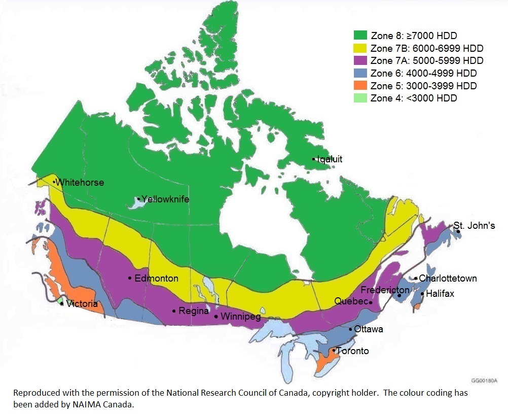

It would be interesting to know how they insulate properties in Canada and the differences between their insulation and insulation in the UK. Are you able to offer any sort of input as it would be appreciated?
There is no single insulation code for the whole of Canada - see here
