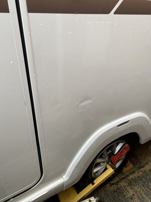

I thought I'd post a warning following a monumental error made by me earlier. After a catalogue of problems with our caravan we have changed it, I needed to remove the Isabella wheel arch draught cover strip which is fixed in place with 3M tape, as usual I used a length of MIG welding wire and carefully sawed through the tape like a cheese wire, no issues but there was a lot of tape left stuck to the panel. I decided to use my wife's hair dryer to soften the tape up to remove it, this is where things went horribly wrong........
I used the dryer on it's highest setting and held it close to the panel, I have a fair bit of experience with GRP and knew it was tough stuff (I now know different). As I heated the first bit the tape softened but suddenly the GRP surface started to go out of shape, in a panic I removed the heat and pushed the blisters back down, creating an indentation in the panel!!!!
It turns out that the outer GRP skin on Swift's really is very thin and nowhere near as robust as I assumed. The rest of the tape was removed "cold" by picking it away. The damage is about 5" x 3" and obviously needs repairing. Honestly, I could have cried. Only myself to blame, the dealer will get it sorted when we take it in but it'll be costing me between £300 and £400! If we were keeping the caravan I think I'd add a vent cover over it!
I'm not looking for sympathy as it's my own daft fault but I have read before of people using hair dryers to remove tape etc, just be careful folks, it really doesn't take much heat to go out of shape.

Aluminium will of course deform , probably faster than GRP..It’s not a big dent. Have you considered a mobile body shop firm. May be cheaper than the main dealer, who may use an outsider anyway!

It isn’t just a dent, it’s out of shape (proud bumps) as well as an inward dent. The dent was where I panicked and pushed the bumps back down. The dealer has photos and will talk to their body repair people on Monday. Either way it’ll cost me, but if it’s too much then I’ll have to go through the insurance.
The reason for highlighting this is to make folks aware that the oft-quoted robustness of GRP sides is great BUT it’s extremely thin and susceptible to heat damage if you’re clumsy like me.

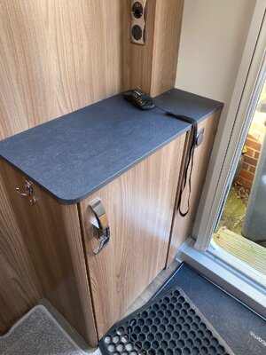

Well, I have just been emptying the caravan in preparation for it going in as a part-ex and now my tears have dried I had a better look at the damage. It is directly behind the cupboard, not the shower enclosure as I first thought and a second external mains socket would be a handy addition just there (IF the door doesn't foul it when open). It would certainly be an easier repair (and one I would have done myself before telling the dealer if I'd been thinking straight!). I'll see what they say when I take it in.2.jpg

I bet they will rip you off,, £500 , and then just rub it down, fill and respray.
