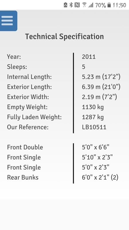

I'm looking for some advice please. I'm trying to buy my first caravan (ideally a 6-berth) and have found one that is basically perfect. However, its MTPLM is 1440kg which is about 100kg more than I was originally looking at and because I am buying a car to tow at the same time has basically blown my car research away!
I'm on a post-97 B licence only so was already quite restricted on car choice but this 100kg step up has made it even harder and I'm struggling to find a car that has a kerb weight greater than the 1440kg (I've accepted I'm going to struggle to meet the 85% guidelines) but also a max laden weight under 2060kg to keep me under 3500kg (as well as having to factor in the towing weight and towball limits too!). The car also needs to be a decent one for someone with no towing experience!
Has anyone got any advice or guidance on cars out there that might do the job?
The caravan I'm looking at is also quite long (7.15m), which is quite a lot longer than I'd originally planned. Does length make much difference when towing or does an extra metre or so not really make much difference?
Thanks for any help!
