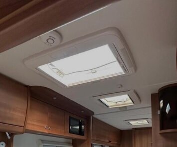

I have a 2020 Elddis Affinity 520 which has developed a leak from the large skylight which runs most of the length of the lounge. We are expecting the dealer to sort it out but this is the third leak in five years. I would like to remove the large plastic surround to take a closer look to identify where the ingress is taking place but can’t see any obvious fixing points. Does anyone know how to remove the surround?

Martin-E He was asking about the plastic surrounding the skylight (see photo) not the window itself .These either have secret screws covered with caps or they clip on to a frame underneath which is screwed to the roof , some have detachable corners which when pulled off revealing the screws . Having said all that , the advice the other members have given stands , if under warranty don't mess!
I am taking your advice. Going in to dealer on Saturday for service and replacement of front (leaking) skylight so it will be investigated then.
