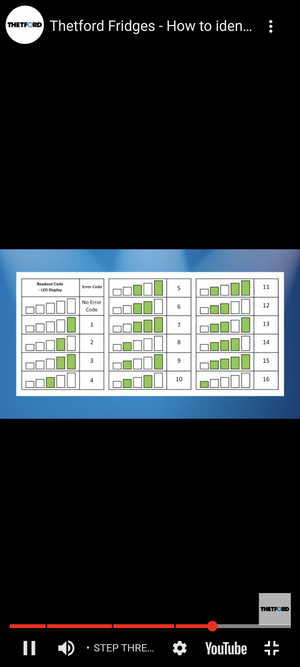

It's a Thetford fridge MODEL N4142E
When switching on all lights flash with power switch showing red
When you select either Gas/Electric/Auto then temp it doesn't accept and then start flashing. The error lights are 1&4 not lit and 2/3/5 lit. Dealer didn't have an answer but calling me back tomorrow. Other than that I'm going to have to return it to them again which I'm not happy about. 3 x out and 3 X back to the dealer with another to go to repair Kitchen worktop.

That’s error 11, no energy source is available and control board is in auto mode.
Have you tried to manually select the fuel source?

On our 2nd trip 10 days later the very first night floor issue reappeared . Again on return dealer resolved the issue quickly. We also mentioned an issue with the kitchen worktop which was identified as delamination so claim put in to Bailey and authorised but part not available until at least April. Now the issue with the fridge on our 3rd trip which today has been shown to be an issue with the Thermistor wiring. TBH we love the van but losing faith in it as every trip sees a return to dealer and it's only 10weeks old which is ridiculous. I have no issues with the dealer as they have done what was asked and I suppose you have to expect some niggles.
