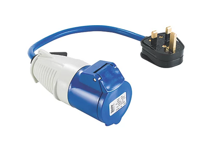

Which is why if you use one of these adapters at home:
Spend another £10 on an earth rod and cable, and ensure your van has a local earth, these things should come with a warning but they don't!

Is it being suggested that the mains adaptor is dangerous and shouldn’t be used??
Surely they wouldn’t be allowed to be sold if it was so dangerous?

How come it's possible in 2025? ; basically because the wiring regulations relating to earthing are different for a caravan site to a domestic property, if they are followed everything is safe, however plugging a van in to domestic mains is introducing parts of the regs that are not required for a house.
To explain; there are different ways of providing an earth to domestic property, but by far the common especially in new buildings is TN-C-S: which stands for "Terre Neutre-Combiné-Séparé" (Earth, Neutral-Combined, Separate), In this system, the neutral and earth conductors are combined (TN-C) in the supply network but then separated (CS) into individual neutral and earth conductors at your house. The danger occurs as explained in the video, when there is a fault between the earth and neutral outside of your property .
When a caravan or motorhome is plugged into house mains with TN-C-S earthing, it' s not adhering to the UK Electrical regulations, but most folk (as one would expect!) wont understand what the regs are let alone what earthing system their property has!
The adapters themselves are perfectly safe in the correct situation, but that won't be with a high proportion of UK houses. Getting some sense of reality, the frequency when this sort of fault occurs is rare, but considered a high enough risk that caravan and camping sites are forbidden from providing mains with TN-C-S earthing.
