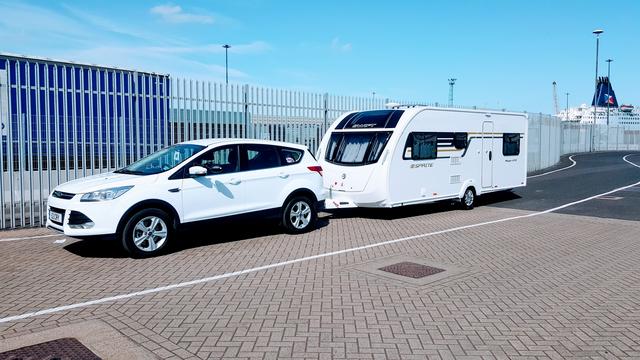

Should pull it no bother as we have one also as you can see in my profile picture, thing is will your licence cover you as there's a chance you'll be over 35oo'kg if your licence is registered after 1997 ? If your pre 97 then its no bother .

That's 2 week's worth of kit for 4 people and the caravan loaded with the bikes on the back and the car managed no prob .
