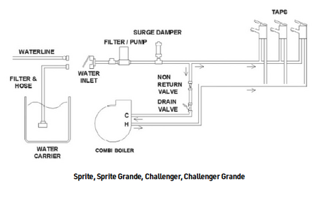

The 2023 Swift handbook suggests you have an on-board pump (see below) - our 'van has one - check before buying!

I thought what I purchased would just allow a better flow from the aquaroll to the Caravan which uses an internal pump (as pictured above) to draw the water in, and also stop any kinks.

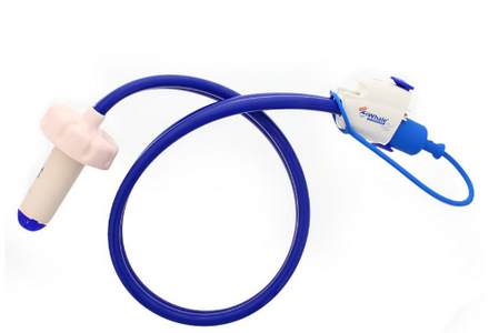

What you require is an Aquaroll to caravan hose. It has a connector fitting at one end to go into the caravan. At the other end in the aquaroll it has a plastic strainer. It also has a moveable soft plastic “mushroom” cap that you slide along it to cover the aquaroll opening.
From your explanation what you have bought is wrong.

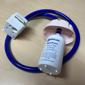

Any idea which one I should be purchasing bud?
As in most things life gets more complex. This one should fit but you need to check the connection to the caravan. Now they seem to have a filter. Never used filters outside or inside the caravan as supplies here and in Europe are good. I guess the advantage of the filter is that it keeps the hose inlet on the bottom of the aquaroll. But then there’s a cost to periodically replace it. ☹️
But as posted above your caravan should have been supplied with the aquaroll to caravan hose fitment as if off grid your long hose may not be suitable to reach the tap which may be a communal tap anyway.

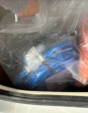

When I opened the front section I could see a step, the AL-KO Wheel Locks, an Aquaroll, coiled Elec Cable and lastly a coiled hose which looked long and more for the tap (see below)

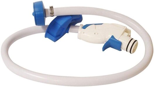

That’s too long for connecting the aquaroll to caravan. This is the sort of thing we are talking about. This is Truma Ultraflow inlet hos but for the life of me I can't find a Whale equivalent other than the one I posted earlier but at three times the price as its more complex and includes a filter. Available on Amazon £20.48

Must be this one I require?
Will check other shops apart from CAMC
Thats it and not a bad price as some are advertised at £61. But even so I think it is unnecessary expense and complication which the caravan industry seems hell bent on doing. For aeons caravaners and motorhomers have used a basic hose connector without filter and are still alive to tell the tale.
