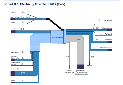

There is a chart that helps show this. Here is one version of it (a subset on electricity generation) from 2022. 1761852031093.png

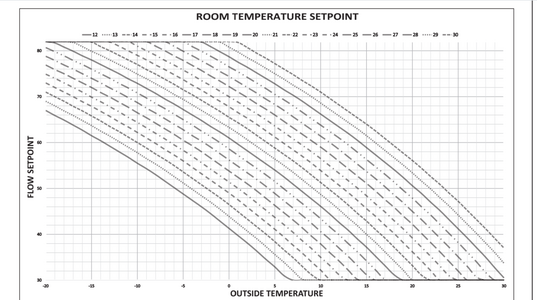

I have just had to replace a gas boiler, unfortunately I couldn't afford a heat pump, too much pipework to change to get the efficiency. So I went for a gas boiler with temperature compensation, this means you set the temperature that you want the house to be on the boiler and the boiler decides on the flow temperature needed to heat the house according to the outside temp.
I'm surprised just how cool the system now runs, it's yet to be cold enough outside to necessitate the 55deg flow temp I used to have the old boiler set at.
The boiler rarely gets to full output unless it's heating water when the flow temp is 80deg only do this once a day when the heating starts in the morning it also means the house heats quickly before dropping back to low flow temps.
The flow v outside temp is shown below.
There is also cheap <2p electricity tonight and tomorrow night is <0. Much house battery charging going on after the higher prices of the last few days.

I was aware of a boiler system that did this back in the early 1970's, and it seemed to work quite well. It wasn't a condensing boiler.
This is a condensing boiler and has an outside sensor, the alternative was an Opentherm system but that meant changing the whole control system.
We shall see how I get on with it, can change to Opentherm if I get bored.

By just setting house temperature on the boiler how does it sense for example a lounge temperature, which you may require to be 19 deg c in the evening, but with bedrooms at a lower temperate. Our Worcester Bosch modulates its gas firing rate as the central heating warms up, and as the hot water tank is heated between 0730-0930. But in the lounge we have a Hive thermostat and all radiators have TRVs. We move the Hive around, for example if we need to use the dining room the Hive goes in there to bring it up to temperature, whilst I will throttle back the lounge TRVs to prevent that room going too high. Sounds a bit Harry Tate but it’s worked for us very well. Our boiler is now 11 years old and like you when the day comes to replace it tgen it will be a gas boiler for the same reason you have chosen. Although if electric prices fall I’d love to go back to the whole house panel rads we had fitted to our first house. Each rad had a thermostat, house divided into zones etc. Very comfortable and no maintenance either.
