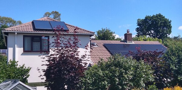

But depending on where you live and how much at home time you have. Solar Panels may take from 11 to 15 years or more to recover the installation cost.
About 8.5 years payback here and we are almost half way there.
It was predicted to be 11 years just before the electricity prices went up but due to that and decent tariff management it's come down to about 8.5 years. I don't need the money back as I can't take it to the grave so will be content with between 11 and 12% ROI.
The "payback" period can only come down as prices rise.
I would say that my solar installations* have added their value to the overall house value so I haven't "lost" the money at all.
* Solar PV and Solar Thermal for hot water.
If you'd saved your outlay for 8.5 years at 4% per year, compounded, you'd have got about 36% and still have the initial amount.
