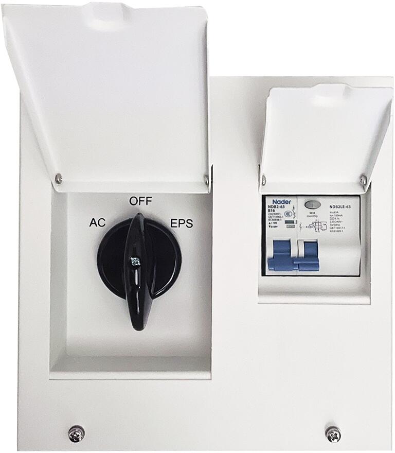

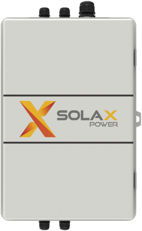

Our Solax battery was supposed to power the house in the event of a blackout, we found out apparently not, we need another device added for it to power the house in the event of a blackout
It's a simple matter of adding a contactor between the EPS output of the inverter and part of the main CU input and adding a separate earth rod. Took 2-3 hours to do. Parts if not using solax bits are less than £120.
Solax make two EPS boxes
One manual
One Auto
Alternatively you can wire a 13amp plugboard through an RCBO from the EPS output and distribute it to wherever you need it.

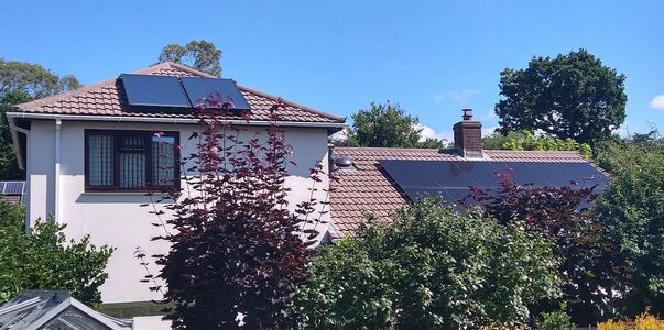

But depending on where you live and how much at home time you have. Solar Panels may take from 11 to 15 years or more to recover the installation cost.
About 8.5 years payback here and we are almost half way there.
It was predicted to be 11 years just before the electricity prices went up but due to that and decent tariff management it's come down to about 8.5 years. I don't need the money back as I can't take it to the grave so will be content with between 11 and 12% ROI.
The "payback" period can only come down as prices rise.
I would say that my solar installations* have added their value to the overall house value so I haven't "lost" the money at all.
* Solar PV and Solar Thermal for hot water.
One manual
One Auto
