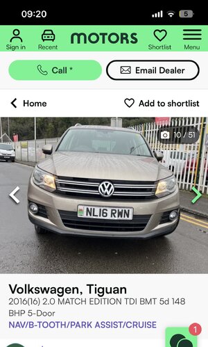

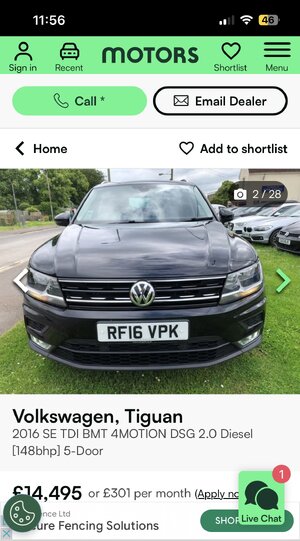

Hi Hatch, thanks in advance for your help there’s so much information online it’s getting confusing. Really I would just like a car that would safely tow my car caravan. I feel like I’ve been going around in circles. From looking at different makes, 4wd oe 2wd? Manual or automatic 🙈 there’s so much into towing caravan’s! I’ve attached pics of two cars below with regard to your previous post. Thanks again 😊 the Tiguan (gold colour) is diesel manual and the black Tiguan 4Motion is diesel automatic

Gemlou, this is from Parkers. I hope this helps you a bit more.
NL16RWN. , kerb weight 1522kg,
RF16VPK. Kerb weight 1650 kg.
Thank you, looking at the kerbweights the first car wouldn’t be any good? The second car would be more sufficient? As it’s only 650 more than the weight of caravan if keeping caravan light and maybe loading more in the car would this be ok? Also would nose weight be considered as weight to the car ?
12,420
4,590
Remember to add another say 30 kg for a tow bar, so the lighter car would come in at 1550 "ISH"kg, you realistically never tow with a car at kerb weight and the caravan full. So either car would be suitable. But my preference would be the heavier car.

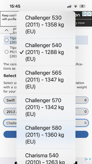

Think I’ve made a mistake using tow info. Does the weight refer to laden weight or the unladen weight? The model I have is a swift challenger 2009 the caravan didn't come up on tow info so I pressed the below , please seepic thinking it was the unladen weight which is 1288kg which is not much difference to the unladen weight of my caravan which is 1294kg. (The Maximin Technical Permissible Laden mass is 1500kg 🙈 hoping it’s ok 🤞🏻)
