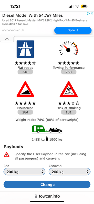

Thank you, so the weights of the caravan shown in the pic from tow info relate to the unladen weights of the caravan ??

According to Google. The MPTLM ( Maximum Permissible Towing Laden Mass i.e. the van and all your stuff cannot weigh more than this) of theCaravan is 1500 kg. This is the value that you work with
The fact that the picture shows 1288 kg, and other pictures you have posted in #24 show 1488 kg indicate a caravan at Mass in Running Order (1288kg) with a 200kg payload which gives a MTPLM of 1488k, which is very close to your caravans MTPLM of 1500kg. Given the year of your caravan the 1288kg could be its unladen weight. Which is basically an empty caravan, no gas bottles, no battery etc. So your 200kg payload has to account for everything you put into it including gas, battery, mover if fitted etc plus all your othe equipment and personal stuff. Does your label by the door, or owners manual give details. Alternatively around the time of your caravan Mass in Running Order came in. MIRO/MRO fir your size caravan would have included the weight of one 10kg gas cylinder (6kg gas plus 4kg cylinder), electric cable, steps, portable water pump/hose unless internal fitted, documentation and handbooks. So if it’s MRO you have another 200 kg payload, if it’s unladen weight you have less payload.

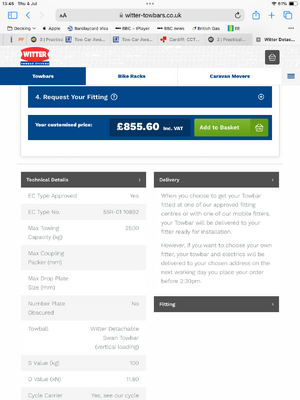

Entering the OPs selected cars registration into the Witter website it gives 100kg S value., which correlates with the Towcar Awards value for a 2.0 Ltd diesel 4 motion DSG in my post #62.
Yet the Westfalia fixed and detachable say 150kg. So either way the OP has plenty to play with. Although I assume the caravan hitch load limit will be 100kg.

That strikes me as particularly high for a Tiguan. Could that website have made an error. The Towcar awards for an almost similar model to the one the OP likes is 100kg. Seriously the OP really needs to eyeball the cars owners manual as parameters are chopping and changing which will cause potential problems if the OP gets it wrong.

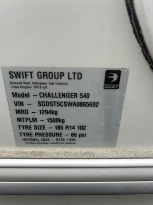

Hi, I’ve just been to caravan and taking a pic which gives weights. Please see below pic 2. So is it right the MR0 is 1294kg so I have another 200g because of the year 2009 thr mro included the weight of like you said below 10 kg gas cylinder a.s.o ?

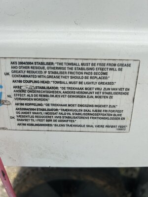

Also I’ve taken another pic of sticker near the hitch which I’ve attached below. Does this refer to al-ko which you referred to in another post to find out max hitch load ??Thanks so much!
That’s fine. You should have a payload available of 206kg. Be aware that if the van has been fitted with after market items such as mover, solar panel etc they come out of payload.
Wrt noseweight I’m sure your caravan will be limited to 100kg so even if the car can take a higher noseweight the lowest wins, so it’s the caravan that limits usable noseweight to 100 kg. What does the caravan owners manual say?
Wrt your first photo do not grease your towball as that part of the instructions isn’t relevant to you. In fact I’d ignore the lot.
