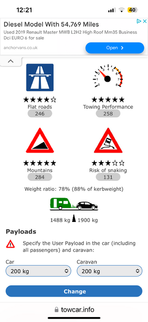

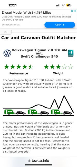

Thank you the car dealer just said that the kerb weight of car is 1605kg and the GVW is 2330 k, I was going by 200kg payload on both caravan and car to try keep it at 85% -89% kerb weight, is that right please? We’re just off to see the car now

The car doesn’t need to be restricted to 85%-89%. Forget it as it’s not relevant once load is put in. The minute you start to load the car the weight increases which immediately goes away from the 85% guide for the outfit. You are getting unnecessarily anxious. You cannot keep each part at 85% it’s impossible as putting weight in the car changes ( and improved) everything. Forget the 200kg in Towcar. Info as it’s only relevant to that matching calculation.
With a 200kg payload that means with 5 passengers you cannot even put fuel in the car which is why i think the car payload is probably about 500kg if that makes sense.

The OP hasn’t really understood the Towcar.info calculation as it allows the user to make changes to payload for car and caravan plus variations to noseweight too. But if you insert figures above the car or caravan maxima you get a positive warning.
