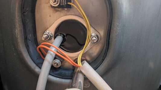

During travelling I think something knocked the switch for the Ultrastore water heater..... So when I plugged in it's fried the element, lesson learnt and I've already 3d printed a cover for the switch so it can't happen again. So long story short I need a new one.... But I can't find one that matches.... They all seem to be a two wire version where mine has one. Can anyone help with a part number?

Unfortunately, its not just the number of wires but the mounting plate may well be different, so sadly you do need to find a direct replacement element.
However apart from the cost of the gas, its very nearly as efficient to use gas to heat the water, especially if you selectively only turn it on about 30 to 45 Min before you need it, and turn it off afterwards.

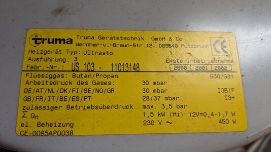

That looks like the 450w element and is no longer produced, you might find one but they are around £900 + the only solution is to change the water tank to the 850w tank and fit the 850w element
I'll have to have a look.... Does the 450w have a built in thermostat? Depending on the mounting shape I can probably produce an adapter plate. But it's all getting a bit extreme...
Changing the water tank, would I be able to leave all gas and everything as it is?
** Just looked and replace tank, and they all say suitable for 450w or 850w(hopefully mine is too......)So potentially the issue would be the thermostats

The 850w tank has an extra pair of studs for the temperature sensor.
Gas side will stay the same as will water connections

Its unusual for an electric element to fail and the gas to stop working at the same time. The systems are separately controlled, so that points to a more serious failure, and changing a tank to facilitates the electric element is unlikely to fix the gas as well.
The heater is at least 23 years old, it may be more prudent to consider replacing the entire heater .
