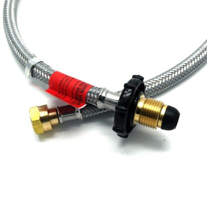

If getting new pigtails I would recommend the handwheel type as in the picture. No more spanner searching and then trying to tighten in an awkward position.
Tried that but arthritis does not allow me to tighten properly.

You need very little tightening on the hand wheel type as they have a rubber sealing connection.
Apologies for the misunderstanding. Two years ago I blanked off the second hose, but never replaced it.
As for the hand wheel as I thought it was not tight enough, I changed it for a normal hose as at least I ca still hold a spanner. Maybe I was too worried about gas leakage when hand tightening which was a bit painful on my wrists and fingers.

We have decided to invest in the Gaslow 450mm stainless steel pigtail with the handwheel and are ordering from Hamiltons. Thanks for the advice.
